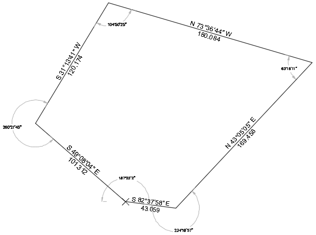

Use the COGO Editor to create and adjust 2D traverses.
Temporary graphics, as shown in the following example, are displayed in the drawing when you enter traverse data in the COGO Editor.
These graphics disappear when you close the COGO Editor. You can use the Create Polyline From Traverse
and Add COGO Points to Drawing
options to insert objects into the drawing that are based on the traverse data.
When you enter data for a traverse side, the zoom level in the drawing is changed as needed to display the traverse graphics in the drawing window.
When you select an adjustment method on the Balance tab, additional graphics are displayed in the drawing to show the effects of the adjustment.
