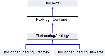

+ Inheritance diagram for FbxPluginContainer:
