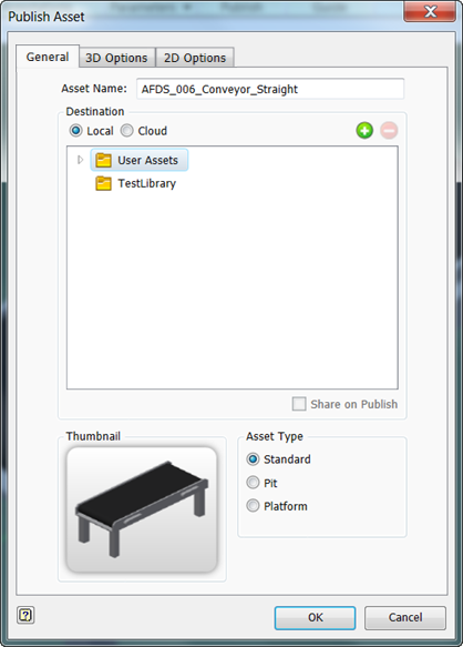

Publish panel
Publish Asset

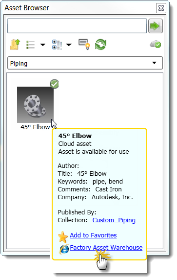

to the right of the asset collection name.)
and Remove
buttons if you wish to add or remove a collection from the list. Adding a collection creates a new folder that can be named at creation time or renamed later, as required. Once the asset has been published to the cloud, it becomes available for download in the Assets Browser. Access to the Factory Asset Warehouse is also provided through the browser for cloud-based assets.

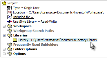

to exit the environment. A Project Library is a folder that contains frequently used standard parts that are referenced and used, but not modified as part of a project. Project libraries usually contain off-the-shelf parts like fasteners, o-rings, retaining clips, electrical components, etc. You can create your own factory assets and store them in a specially designated Project library folder on your local machine, or on a network to be shared with others.
Once the folder is created, use the Project Editor to specify the location of your Project Library.
When the project is active, the Project Library appears with the name Library in the Publish Asset dialog box.
Any new factory assets that you create and publish can now be added directly to the Library folder. For more information on Inventor projects, see the Inventor help.
