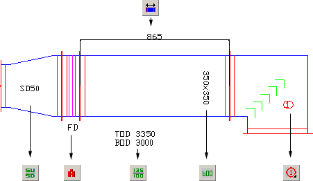

CADmep annotation tools are used to apply dimensions and additional fitting information onto fabrication objects.
Annotation Types
Each annotation command is covered in greater detail in the following topics. Click one of the links below for more information.
Transition and Sets text
Item Alias text
Item Levels text
Item Lengths
Item Sizes
Item Numbers

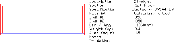

Additional information can be displayed for each item in the form of Item Pattern Information.
Although this option is not available from the toolbar, it can be accessed from the Shift + Right-click menu. For more information, see Setup Item Information for Display.
