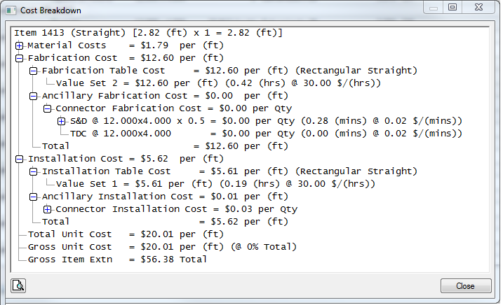

The Cost Breakdown dialog displays all of the cost information assigned to an item, including material costs, fabrication cost, installation cost, total unit cost, gross unit cost, and gross item extension cost. A sample Cost Breakdown dialog for a rectangular straight is shown below.

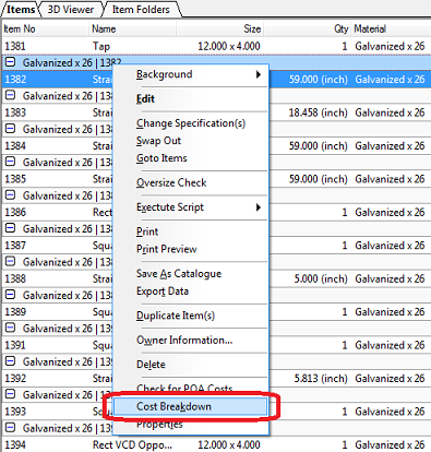

To display a Cost Breakdown dialog in ESTmep or CAMduct, right-click on an item in the Items tab and click Cost Breakdown. In CADmep, right-click on an item in the model and click Cost Breakdown.

Cost Breakdown information comes from a variety of sources, including Price Lists, Fabrication Tables, and Installation Tables. For more information, see Price Lists, Fabrication and Installation Times, Value Sets, and Gang Rates.

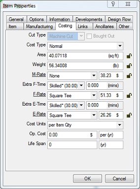

The following Item Properties dialog is for a machine cut item (square tee).

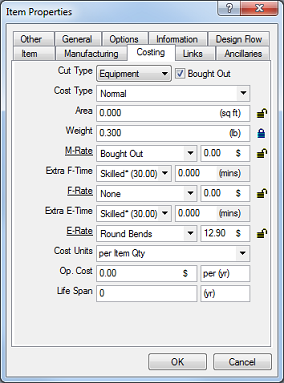

The Item Properties dialog shown below is for a bought out piece of equipment (round bend).
