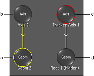

  12. Press ~ (the tilde key) to enter the Schematic view.
    You should see the axis and geometry of the tracked shape and the graded shape.
    (a) Geometry of graded shape  (b) Axis of graded shape  (c) Axis of ROI  (d) Geometry of ROI  
  13. Position your cursor over the edge of the circle representing the ROI axis and left-click and drag a line to the edge of the circle representing the graded shape axis.
    The graded shape is now linked to the ROI and therefore follows its tracked path.
