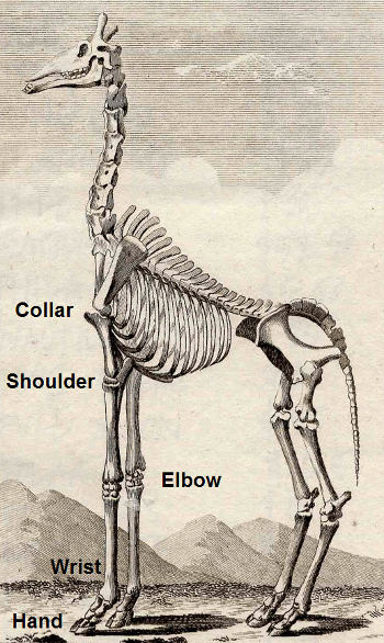

This page gives some suggestions for how to characterize a giraffe skeleton for use with HumanIK. Note that there are many possible ways to characterize a giraffe; the suggestions below may or may not be appropriate for use with your own characters.

Despite their intimidating length, the giraffe's hind limbs are not difficult to characterize:
HIKInverseJoint(character, HIKLeftKnee, 1); HIKInverseJoint(character, HIKRightKnee, 1);
For the forelegs of the giraffe, it is recommended that you characterize the complete joint chain understood by HumanIK:
HIKInverseJoint(character, HIKLeftElbow, 1); HIKInverseJoint(character, HIKRightElbow, 1);
This characterization will ensure a maximum of flexibility for the forelimbs, especially on the upper parts of the limbs.
