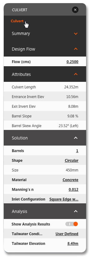

  1. Click the culvert to display its asset card.
  2. Right-click the culvert and select Edit or select from the Utility Bar to enter Edit mode.
  3. Click an editable field in the Analysis and Solution sections to change a value.
Design Flow:
The Flow value is for manually placed culverts where there is no watershed nearby. If the culvert is within a watershed, its peak flow value is used. Default values of either 7 cfs or 0.25 cms are used to size a culvert if no flow information is available.
Attributes:
Adjust Culvert Length and Invert Elevations using gizmos and grips in the model.
Barrel Skew Angle reports the actual angle. In most cases the angle should not exceed 45%.
Solution:
Enter Edit mode to edit Solution values. Click a field to display options and edit values.
  • Barrel: 1 or 2 (or more)
  • Shape: Box or Circular
  • Size: (initially determined by Flow data; change size using in-canvas grip)
  • Material: Concrete or Metal
  • Manning's n : 0.012 for concrete; 0.024 for corrugated metal
  • Inlet Configuration: square or rectangular. Inlet Configurations correspond to a selection of Federal Highway Administration (FHWA) HDS-5 Table A Inlet Configurations.
Analysis:
Tailwater Conditions: The default Conditions use the FHWA recommended (dc+D)/2 value, or the average of the culverts critical depth and the diameter or rise of the culvert. Click the default condition to choose from other options:
