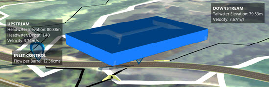

. Drainage Design displays the new culvert.
After adding a culvert, Zoom in to view it. Click the culvert to display in-canvas analysis data and asset card. |
