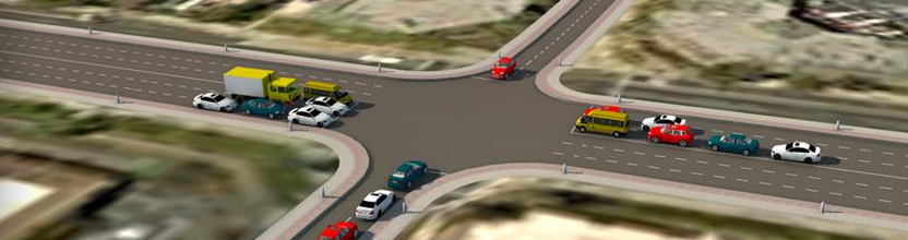

Use the Traffic Simulation tool to analyze traffic flow through intersections, display color-coded traffic analysis results, and generate traffic simulation animations to play in your model. Use the Traffic Analyst panel to specify advanced demand matrices, profiles, vehicle types, driver types, and other variables. Or, use default traffic demand for a quick demonstration.
The Traffic Simulation tool works on design roads so planning roads must be converted. Convert a planning road to a design road using the right-click context menu in Edit mode. See About Design Roads for more information.
