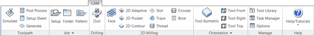

The Inventor HSM Express command ribbon

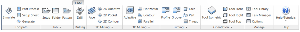

The Inventor HSM command ribbon

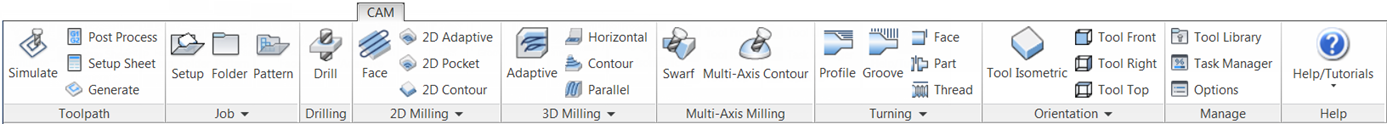

The Inventor HSM Professional command ribbon

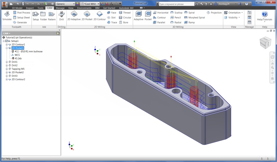

The following example illustrates a 2D Pocket strategy which is used to remove the interior cavity of a part .
Normally a machining operation, like pocketing, is started by creating a Setup. A setup defines a number of general properties for a set of machining operations - including the Work Coordinate System (WCS), the stock geometry, fixtures, and the machining surfaces. If you do not create a setup manually before adding your first operation, a setup with default parameters is created for you automatically. For more information about creating a setup, see the Help topic: Setup Reference.
You select the first operation you wish to perform on the workpiece by clicking the appropriate icon from the command ribbon. In this example, you would click CAM tab 2D Milling panel 2D Pocket .
Remember: As an alternative, you can also right-click in an empty portion of the graphics window to display the familiar Inventor marking menu and click the appropriate marking menu node.
The Operation dialog box then replaces the CAM Browser at the left side of the graphics window, and prominently displays in its title bar the strategy name you selected. Just to the right of the strategy name is the operation number. Since this is the first 2D pocket operation for the part, the name displays as 2D Pocket1. The next 2D pocket operation will display as 2D Pocket2, and so on. This naming convention applies to all setup and machining strategies in Inventor HSM.
The Operation dialog box for the 2D Pocket strategy. Note that the Tool tab is active by default..
The Operation dialog box contains a number of sections with parameters controlling different aspects of the toolpath whenever you create a new machining operation. Inventor HSM provides working default values for all parameters, where possible. The only thing you need to do to obtain a toolpath is to select a tool and the geometry to be machined.
Tip: If you want to display both the Operation dialog box and the CAM Browser in two separate windows instead of combined, disable the Combine Operation dialog with CAM Browser setting on the User Interface tab in the CAM Options dialog box. For more information about CAM options, see the Help topic: CAM Options Reference.
Click the Tool button to open the Tool Library. Select an existing tool from a tool library by expanding the tree, selecting a tool, and clicking the OK button. Alternatively, you can create a new tool by clicking the New Mill Tool button, editing the parameters, and then clicking the Select button.
A Ø6 mm ball mill is selected from the Tool Library
Once you have selected your tool, click the Geometry tab and select the geometry to be machined. For the 2D Pocket strategy, you need to select one or more closed contours. You can select directly from the model by clicking on edges, faces, surfaces, etc., but you can also use any 2D sketch directly.
When selecting 2D geometry, the contours are projected onto a plane parallel to the tool orientation. If the projection looks incorrect, you can change the tool orientation by clicking on the Tool Orientation section on the Geometry tab and selecting a different plane.
Having successfully generated a toolpath, you can see a preview of the toolpath generated on top of the model simply by selecting the corresponding operation in the CAM Browser.

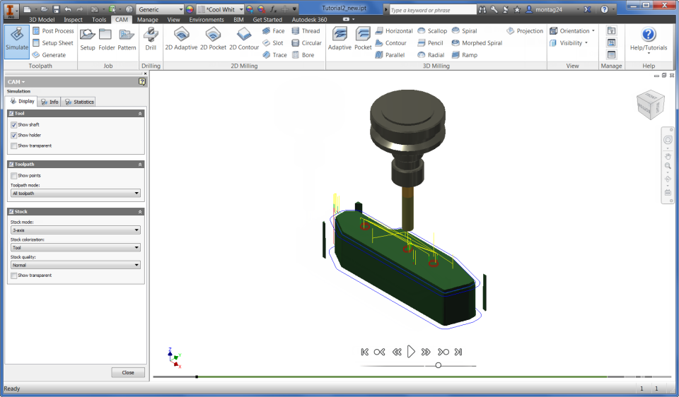

Toolpath Simulation
To simulate the toolpath, select one or more operations from the CAM Browser (multiple operations can be selected by pressing and holding the Ctrl key while clicking with the mouse), and then click CAM tab Toolpath panel Simulate on the CAM ribbon.
Stock Simulation
To invoke the solid simulation, enable the Stock check box in the Simulation dialog.
