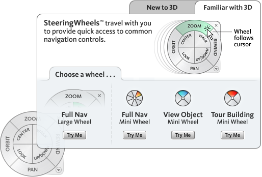

SteeringWheels
There are different styles of wheels available in either the big or mini size.
The primary method of interaction with SteeringWheels is to press and drag a wedge.
When you display SteeringWheels the first time, and a 3D view is current, the First Contact balloon for the wheels displays. The First Contact balloon is an introduction to the wheels.
Appearance of the Wheels
You can control the appearance of the wheels by switching between the different styles of wheels that are available, or by adjusting the size and opacity. Wheels (except the 2D Navigation wheel) are available in two different styles: big and mini.
The size of a wheel controls how large or small the wedges are and whether labels appear on the wheel. The opacity level controls the visibility of the objects in the model behind the wheel.
