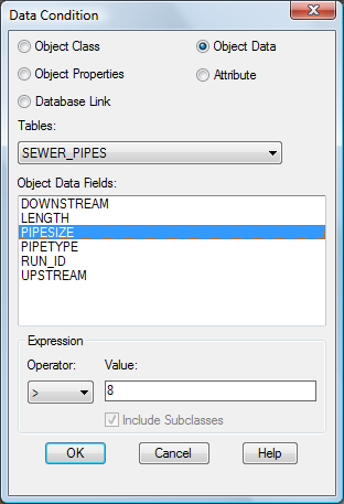

  4. In the Data Condition dialog box, do the following:
    • Select Object Data.
    • Under Tables, select SEWER_PIPES.
    • Under Object Data Fields, select PIPESIZE.
    • In the Expression area, under Operator, select >. Under Value, enter 8.
      Specify sewer pipes that are more than 8 inches in diameter.
    • Click OK.
