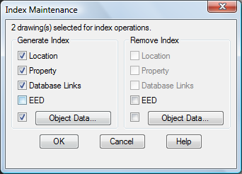

  4. In the Index Maintenance dialog box, do the following:
    • Select all the Generate Index options except EED.
      Select all the options on the left except EED.
    • Under Generate Index, click Object Data.

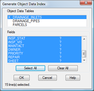

  5. In the Generate Object Data Index dialog box, do the following:
    • Under Object Data Table, select DRAINAGE_INLETS.
    • Click Select All to select all the object data fields.
    • Select each of the remaining data tables listed under Object Data Table and select all their data fields in the same way.
      Select a data table, then select its data fields.
    • Click OK when you are finished.
  6. In the Index Maintenance dialog box, click OK.
