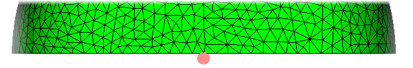

Click the right face of the ViewCube to rotate the part to 90 -90 0. Zoom up so you can see the center of the part at the parting line.
Click
Click the part on the back end, in the center, on the parting line as shown.

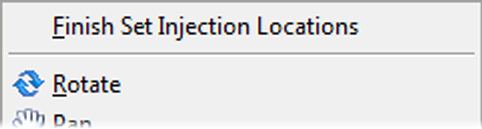

Right click and select Finish Injection locations.
