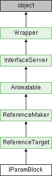

IParamBlock Class Reference
For internal use only. Use ParameterBlock instead.
