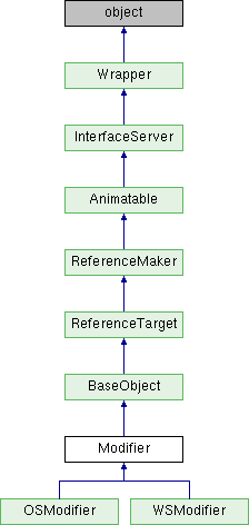

The base class for Object Space and Space Warp (World Space) Modifier plug-ins
+ Inheritance diagram for Modifier:
