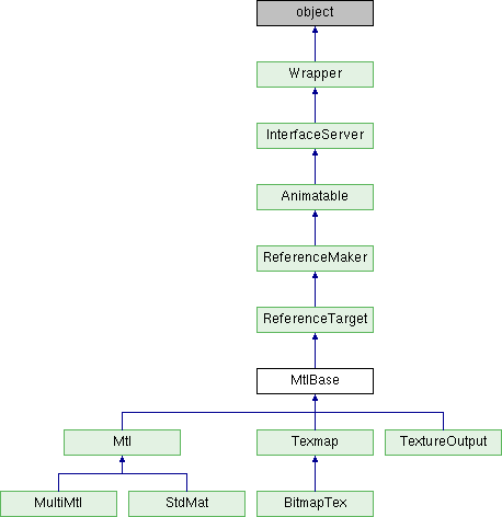

Base classes of texture maps and materials.
