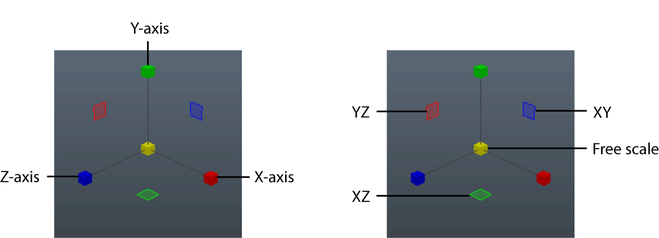

If you want to first change the settings for the Scale Tool, double-click its icon to display its options in the Tool Settings panel.
Drag anywhere along the length of the XYZ axis handles to scale along that axis.
You can also scale objects or components with the Combined Move/Rotate/Scale manipulator or the Universal Manipulator.
