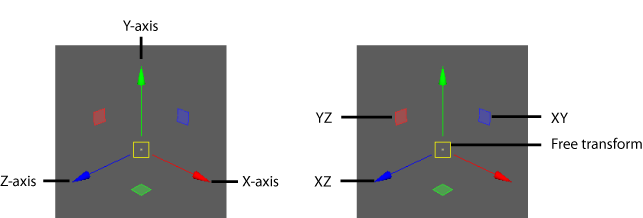

Moving, also known as translation, changes an object's or component's position in space. Movement happens in relation to the pivot of the object. If you have multiple objects selected, they move according to their common pivot point, which is the last object added to the selection (the key object). For components, the pivot point is located at the center of all selected components.
Watch this video to see how to move objects and set several Move Tool options.
To move objects or components
in the
Tool Box or press W.
If you want to first change the settings for the Move Tool, double-click its icon to display its options in the Tool Settings panel.
You can also move objects or components with the Combined Move/Rotate/Scale manipulator or the Universal Manipulator.
To move with precise values, see Move, rotate, and scale using precise values
