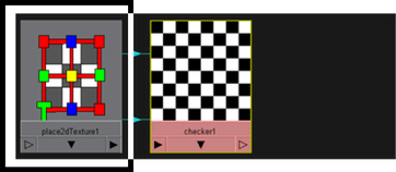

A 2D placement node in a shading network defines a texture's positioning and orientation within the UV space of the geometry.
The 2D placement can result directly from the surface's UV space or indirectly through a projection node (if the texture is projection mapped).
You can scale (repeat), move (position) or rotate a place2DTexture to change how the texture appears on the surface to which it is mapped. Other values, such as coverage and default color let you specify how much of the surface area is covered by the texture frame and the color of the border that surrounds the texture (which happens only if the coverage is set to less than 1), respectively.
Different textures can connect to one place2DTexture node so that they are positioned identically. Edits to the place2dTexture node affect all of the textures to which it is connected. Sharing textures with color, bump, specularity, and other maps that need precise placement is recommended.
