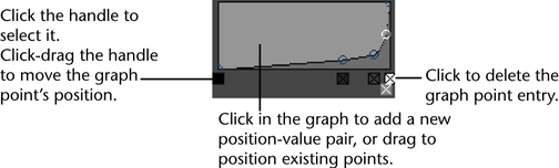

There are two common graphical controls that appear in the Attribute Editor for certain attributes: ramp and graph.
Each color entry in a ramp has a circular color handle above the ramp, and a square color icon below the ramp. The active color has a white border around its color handle and icon. Ramps can be used for many types of gradients, including transparency, color, and so on.
See Set attributes using ramps for more information on how to customize your ramp by adding additional color entries.
The graph control has handles which you can drag in the graph area to set position-value pairs. The active point has a white border around its handle and icon. Graphs can be used for many types of attributes where value changes per position, including paint effect settings, fluid settings, and so on.
Click the arrow on the right side of the control to open the ramp or graph control in a larger window.
For the graph control, you can edit the interpolation method, selected value, and selected position. For the ramp control, you can edit the interpolation method, the selected color, and the color entries. In addition, you can turn on turn off Vertical to switch between a vertical or horizontal layout.
Checking the vertical box alters the size of your ramp. Once you check the vertical box, the ramp or graph automatically adjusts to a suitable size.
