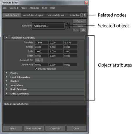

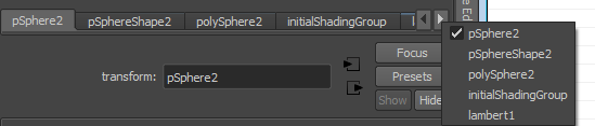

The Attribute Editor lists attributes on the selected object. Tabs across the top of the Attribute Editor let you select nodes connected to the shown node.
While the Channel Box provides a more compact view of keyable attributes for animation, the Attribute Editor gives you full graphical controls to edit attributes rather than just text boxes. See Attribute Editor graphical controls.
