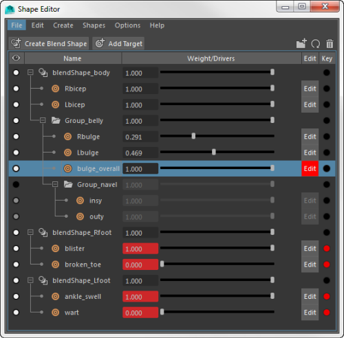

Shape Authoring with the Shape Editor
The new Shape Editor replaces the Blend Shape Editor as the place to create, edit, and manage shapes. New features include soloing, grouping, mirroring, flipping, duplicating, and importing and exporting shapes.
For even more control you can create combination target shapes, add in-between target shapes, and create pre-skinning or post-skinning corrective shapes.
There are several short workflow videos to support this new Shape Authoring workflow.
To open the Shape Editor, from the Sculpting shelf, click , or select Windows > Animation Editors > Shape Editor from the main menu bar.
Note:
  • New target shapes can now also be Tangent Space and Transform Space based. See Add Blend Shape Target Options. UV mapping is no longer required for tangent-space post-deformation target shapes.
  • You can now edit a target shape when its weight value is 0. This is more consistent with how the Transform tools work. See Set weights for target shapes.
