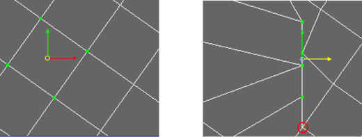

When Snap to Points is on, you can also snap to UV projections along the U or V axis. A UV projection is a straight line in either the U or V direction from a UV. This is useful if you don’t want to snap two UVs together, but want them to line up in the UV Editor.
You can use this functionality on multiple UVs at once to obtain different results.
With the Retain Component Spacing option off, all the selected UVs snap to the nearest UV projection. Notice below that the selected UVs line up with the circled UV beneath them when translated right.

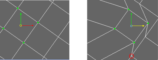

With the Retain Component Spacing option on, the center of the selected UVs snaps to the nearest UV projection. The relative spacing of the selected UVs is maintained. Notice below that the shape of the selected UVs is maintained and only the center of the selection (the manipulator) lines up with the circled UV beneath them when translated right.

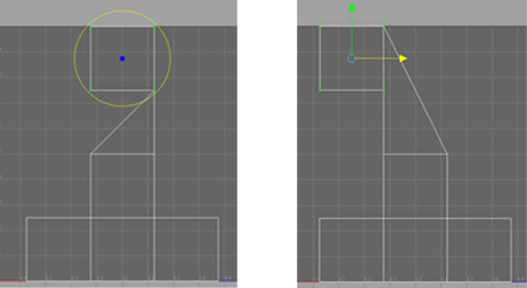

For example, if you want to rotate the upper portion of a cube’s UV shell 90 degrees around its bottom left corner, you can rotate it first, then translate it left.
However, it’s easier and more precise to move the pivot point to the bottom left corner and rotate on that pivot.

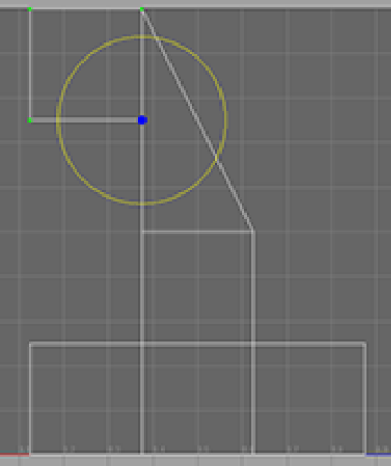

To rotate around a UV
  1. Select the UVs you want to rotate.
  2. Select the Rotate Tool from the Toolbox.
  3. Press Insert or Home.
    The manipulator changes to the move pivot manipulator.
  4. Hold v on your keyboard or select the Snap to Points option in the status line.
  5. Move the pivot to the UV you want to rotate around.
    When you move the manipulator close to a UV, the pivot automatically snaps to it. You can then move the pivot from UV to UV.
  6. Press Insert or Home to return to the rotate manipulator.
  7. Rotate the UVs.
You can use a similar workflow to scale a set of UVs relative to a specific point.
