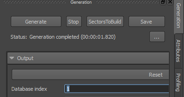

If you have already created a set of NavData for a terrain, you can create another new set with different generation settings by incrementing the value of the Database index control in the Generation panel and running a new generation.
The sectors in the new set of NavData are added to the list in the Scene tab.
