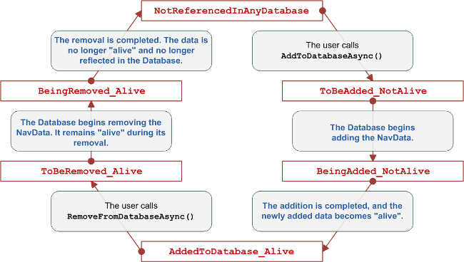

The Database manages all of the complexities involved in tracking the data addition and removal processes. However, it may be useful for you to track the status of your requests, so that you know whether your Bots and queries are using the latest changes you have made to the set of NavData in the Database. Each NavData object maintains its own status value, accessible through NavData::m_databaseStatus, which indicates the current status of that NavData within its assigned Database.
The following image summarizes how these status values are set in response to addition and removal requests. The status values are shown in red, user-initiated actions in black, and internal actions in blue:
