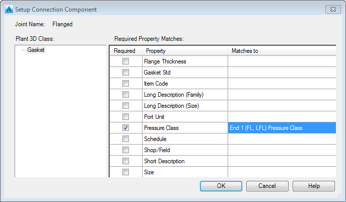

For more information see: Add Joint Dialog Box (Connections).
