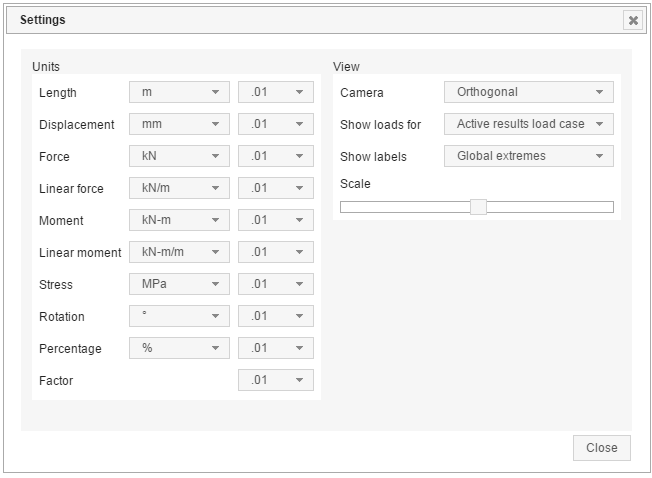

Click the Open settings icon to open the Settings dialog where you can specify unit settings for results displayed in the view, and other display settings for the model and results.
Under units specify units and a number of decimal places for the following values:
These settings are used to display results types in the view.
Move the slider to set the scale for results displayed in the view.
