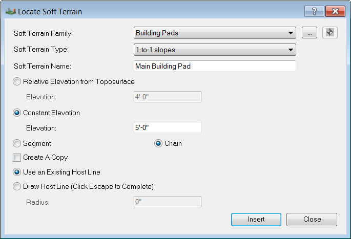

  2. Click Site Designer tabLocate panel, and click the tool for the element to add to the toposurface.
    The Locate dialog displays for the selected element category.
  3. Complete the fields as follows:
    • Family. Select a family from the list, or click the Browse button to select a family to open in the project.
    • Type. Select a family type for the new element.
    • Name. Specify a unique name for this element.
    • Elevation. Specify whether the site element follows the existing terrain (Relative Elevation from Toposurface) or cuts into the toposurface to maintain a constant elevation (Constant Elevation). Enter the distance above (a positive number) or below (a negative number) the toposurface.
      These elevation parameters do not apply to retaining walls, parking lots, or curbs.
    • Segment or Chain. Indicate whether the site element should use the entire host line that you will select (Chain) or only the selected portion of it (Segment).
    • Create a copy. (Optional) When creating an element, Site Designer automatically hides its host line. If you want the host line to remain visible and available for reference in the model, select this option. Site Designer creates a copy of the host line to use as the basis for the site element.
    • Use an Existing Host Line. Select this option (instead of Draw Host Line) so you can use existing geometry as the host line for the site element.
    • The Locate dialog for some element categories have additional or different fields. Complete them as appropriate.
  4. Click Insert.
  5. In the drawing area, select the geometry that you created using the Revit Model Line or Detail Line tool in Step 1.
    If you selected Chain in the Locate dialog, Site Designer uses the entire line or loop as the host line for the element. If you selected Segment, it uses only the selected segment as the host line.
