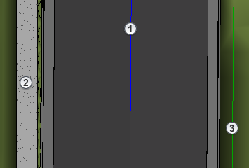

If you want a sidewalk to follow a street, use the "Create A Copy" option when creating the street. This option retains the host line for the street, making it available for reference in the model. When creating the host line for a sidewalk, you can reference the street host line, applying an offset to it.
For example, the following image shows
