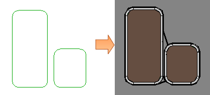

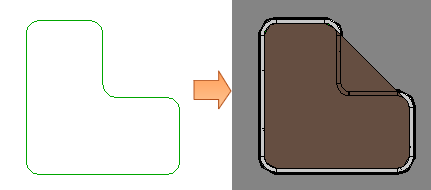

For a parking lot island, create a curb that uses a closed loop for its host line. When generating the island,
Site Designer adds an infill or a capping toposurface.
If the closed loop for a parking lot island includes a concave shape or inner corner, unexpected results may occur as
Site Designer tries to fill in the concave shape with the toposurface.
In this case, try creating 2 closed loops to approximate the desired shape of the island. In the civil engineering plan, the engineer can refine and clarify these details to achieve the design intent.
