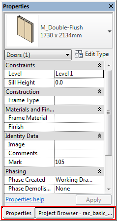

A window group is a way to have more than one window occupy the same amount of space on the screen. When windows are grouped, each window is represented by a tab at the bottom of the group. In a group, click a tab to display that window. You can group or ungroup windows as necessary. In the following image, the Project Browser and Properties Palette are grouped. Notice that the Properties Palette is the active tab.

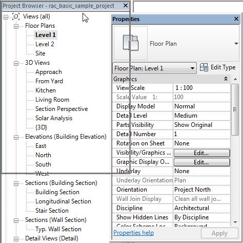

  3. Important: When moving dockable windows, it helps to pay attention to the cursor position and the visual cues. For example, say that the Project Browser and Properties palette are currently undocked and you want them to be stacked and docked on the left. To dock the Project Browser on the left, position the cursor in the title bar, and drag the window until the cursor is touching the edge of the Revit LT interface on the left. The outline of the window gives you a preview. Using the same method, drag the Properties palette. Position the cursor on the lower edge of the title bar of the docked Project Browser, and notice in the preview of the window that the palettes will stack one above the other. (If you position the cursor within the title bar however, above the lower edge, the palettes will display as overlapping tabbed windows.)
