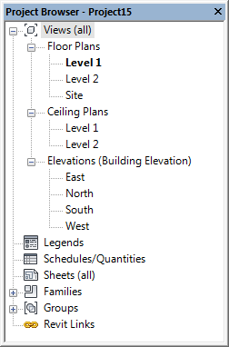

The Project Browser shows a logical hierarchy for all views, schedules, sheets, groups, and other parts of the current project. As you expand and collapse each branch, lower-level items display.
To open the Project Browser, click View tab
Windows panel
User Interface drop-down
Project Browser, or right-click anywhere in the application window and click Browsers
Project Browser.
You can search for entries in the Project Browser using the Search in Project Browser dialog. Right-click in the Project Browser and select Search to open this dialog.
To change the location of the Project Browser, drag its title bar. To change its size, drag an edge. Changes to the size and location of the Project Browser are saved and restored when the application is restarted.
