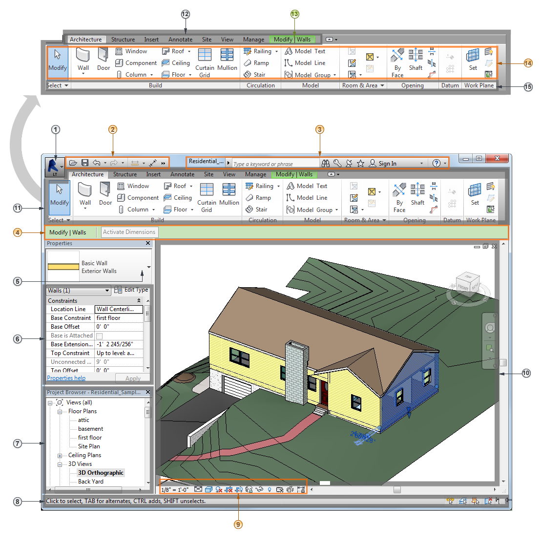

Tour the user interface
Revit LT user interface
1 Application Menu
2 Quick Access Toolbar
3 InfoCenter
4 Options Bar
5 Type Selector
6 Properties Palette
7 Project Browser
8 Status Bar
9 View Control Bar
10 Drawing Area
11 Ribbon
12 Tabs on the ribbon
13 A contextual tab on the ribbon, providing tools relevant to the selected object or current action
14 Tools on the current tab of the ribbon
15 Panels on the ribbon
