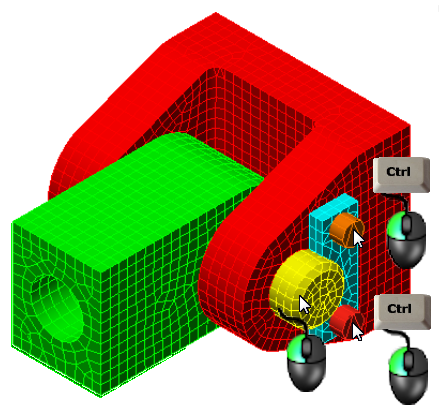

  1. Select the pin. While holding Ctrl, select the two screws.

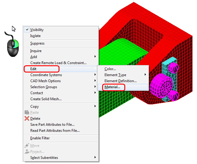

  2. Right-click in the display area, and select Edit Material.

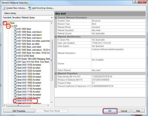

  3. Expand the Steel and AISI branches. Select Steel (AISI 4130), and click OK.
  4. When asked to confirm, click Yes.

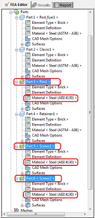

    What it should look like…
