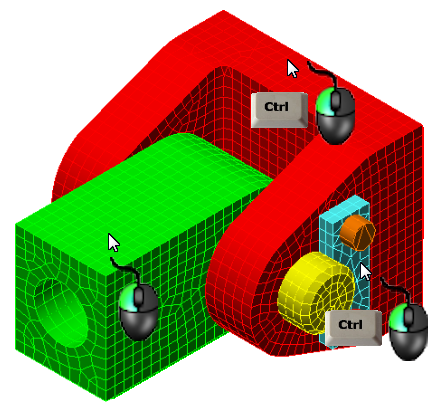

  1. From the ribbon, click Selection (tab) Select (panel) Parts.
  2. Select the rod eye. While holding Ctrl, select the clevis and retainer.

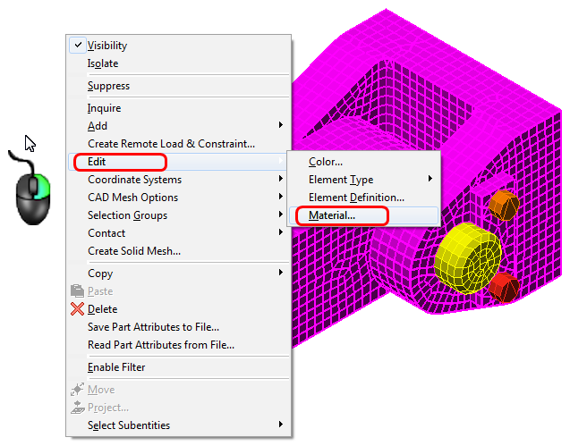

  3. Right-click in the display area, and select Edit Material.

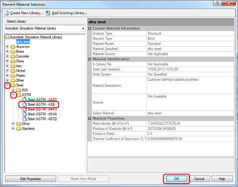

  4. Expand the Steel and ASTM branches. Select Steel (ASTM - A36), and click OK.
  5. When asked to confirm, click Yes.

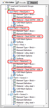

  6. Press the Esc key to clear the parts selection.
    What it should look like…
