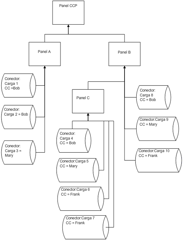

Ejemplo de cargas conectadas y cálculos
Para el panel C
LC Bob
LC Mary
LC Frank
Luces del grupo LC
Total conectado (Panel C) = (4 + 5 + 6 + 7)
Carga de demanda total (Panel C) = DFBob * (4) + DFMary * (5) + DFFrank * (6 + 7)
Para el panel B
LC Bob
LC Mary
LC Frank
Luces del grupo LC
Total conectado (Panel B) = (4 + 5 + 6 + 7 + 8 + 9 + 10)
Carga de demanda total (Panel B) = DFBob * (4 + 8) + DFMary * (5 + 9) + DFFrank * (6 + 7 + 10)
Para el panel A
LC Bob
LC Mary
LC Frank
Luces del grupo LC
Total conectado (Panel A) = (1 + 2 + 3)
Carga de demanda total (Panel A) = DFBob * (1 + 2) + DFMary * 3
Para el panel CCP
LC Bob
LC Mary
LC Frank
Luces del grupo LC
Total conectado (Panel CCP) = (1 + 2 + 3 + 4 + 5 + 6 + 7 + 8 + 9 + 10)
Carga de demanda total (Panel CCP) = DFBob * (1 + 2 + 4 + 8) + DFMary * (3 + 5 + 9) + DFFrank * (6 + 7 + 10)
