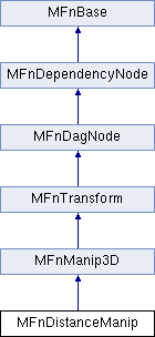

Inheritance diagram for MFnDistanceManip:Public Member Functions | |
