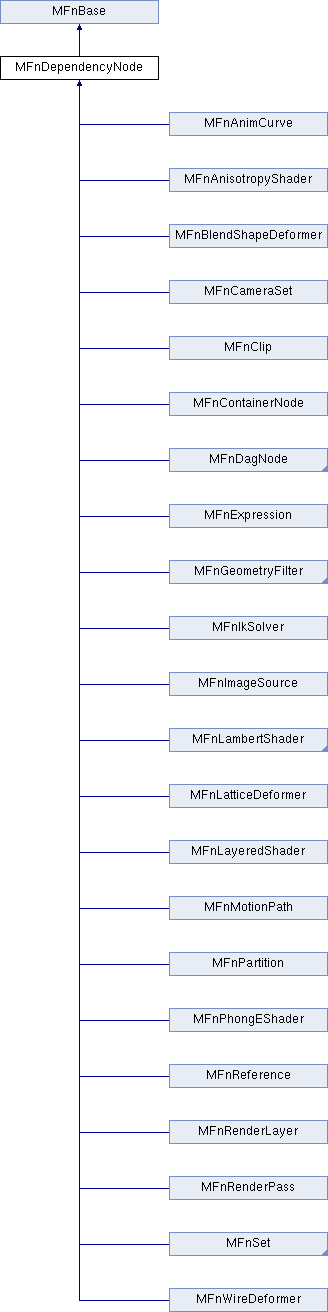

Inheritance diagram for MFnDependencyNode:Public Types | |

Reimplemented from MFnBase.
Reimplemented in MFnSubd, MFnAnimCurve, MFnMesh, MFnTransform, MFnNurbsSurface, MFnClip, MFnCharacter, MFnNurbsCurve, MFnParticleSystem, MFnAssembly, MFnBlendShapeDeformer, MFnIkJoint, MFnWeightGeometryFilter, MFnLatticeDeformer, MFnSkinCluster, MFnCameraSet, MFnLattice, MFnSet, MFnGeometryFilter, MFnDagNode, MFnMotionPath, MFnPartition, MFnFluid, MFnImageSource, MFnWireDeformer, MFnContainerNode, MFnRotateManip, MFnScaleManip, MFnLight, MFnRenderLayer, MFnToggleManip, MFnCircleSweepManip, MFnDirectionManip, MFnDiscManip, MFnRenderPass, MFnStateManip, MFnCurveSegmentManip, MFnField, MFnFreePointTriadManip, MFnHikEffector, MFnInstancer, MFnLayeredShader, MFnPhongEShader, MFnPointOnCurveManip, MFnPointOnSurfaceManip, MFnPointLight, MFnReflectShader, MFnSpotLight, MFnVolumeLight, MFnAnisotropyShader, MFnExpression, MFnIkHandle, MFnLambertShader, MFnPfxGeometry, MFnPhongShader, MFnDistanceManip, MFnIkEffector, MFnIkSolver, MFnDragField, MFnNewtonField, MFnNonAmbientLight, MFnNonExtendedLight, MFnRadialField, MFnVortexField, MFnAmbientLight, MFnAreaLight, MFnDirectionalLight, MFnGravityField, MFnTurbulenceField, MFnUniformField, MFnVolumeAxisField, MFnAirField, MFnBlinnShader, MFnCamera, MFnReference, and MFnManip3D.
protectedvirtual |
Class name.
Return the class name : "MFnDependencyNode".
