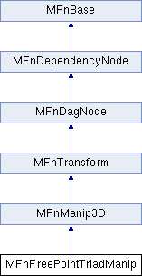

Inheritance diagram for MFnFreePointTriadManip:Public Member Functions | |
