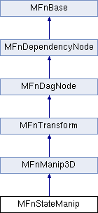

Inheritance diagram for MFnStateManip:Public Member Functions | |
