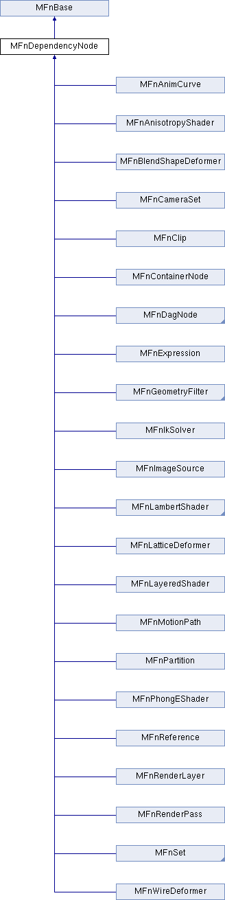

Inheritance diagram for MFnDependencyNode:Public Types | |
