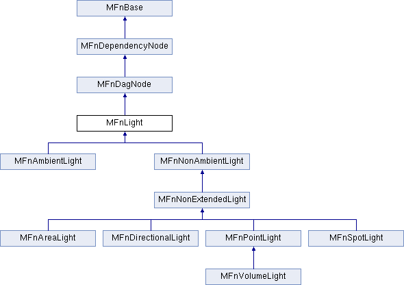

Inheritance diagram for MFnLight:Public Member Functions | |

virtual |
Function set type.
Return the class type : MFn::kLight.
Reimplemented from MFnDagNode.
Reimplemented in MFnPointLight, MFnSpotLight, MFnVolumeLight, MFnNonAmbientLight, MFnNonExtendedLight, MFnAmbientLight, MFnAreaLight, and MFnDirectionalLight.
protectedvirtual |
Class name.
Return the class name : "MFnLight".
