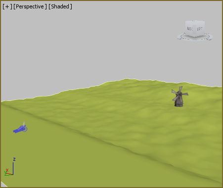

    The Perspective viewport should be active, indicated by a yellow border. If no border is visible, right-click anywhere within the viewport to activate it.

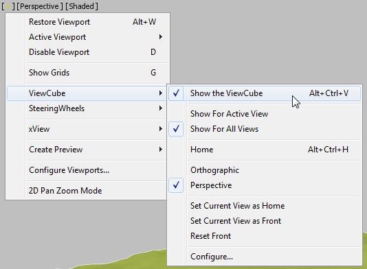

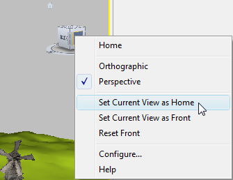

  2. If the ViewCube is not visible, click the Perspective viewport's General label—which looks like "[ + ]"—and choose ViewCube Show the ViewCube.
  3. In the Perspective viewport, right-click the ViewCube and choose Set Current View As Home.
  4. Click the Left face of the ViewCube to view the scene from the left.
    As you can see, the ViewCube lets you view the scene from alternative viewpoints with a simple click of a mouse.
  5. In the Perspective viewport, click the Home icon to the upper left of the ViewCube.
    The Perspective viewport returns to its initial viewpoint.
    Note: You can reset the Home viewpoint to the current view at any time by right-clicking the ViewCube and choosing Set Current View As Home.
  6. Click (Zoom) in the viewport navigation controls at the lower-right corner of the 3ds Max window.
    To show that this control is now active, the button is highlighted.
  7. With the mouse, drag downward in the Perspective viewport.
    Your view zooms out so you can see the scene from a distance.
    Note: You can also zoom in or out by rotating the mouse wheel forward or backward.

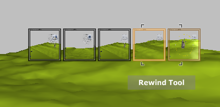

  3. When you’re done, click the Rewind button and drag to the left.
  4. The Rewind tool passes over a strip of thumbnails, each of which represents a previously selected navigation point. Release the mouse on any thumbnail. The viewport rewinds to that point.

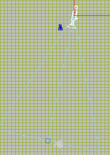

Creating a camera:
  1. Right-click the Top viewport to activate it.
    The viewport outline highlights.
  2. On the Create panel, activate (Cameras), then click to activate Target.
  3. In the Top viewport, click behind and slightly to the right of the cannon, then drag down to a point just left of the windmill (as shown in the following illustration). Don’t worry about the exact camera placement yet: You will adjust this later.

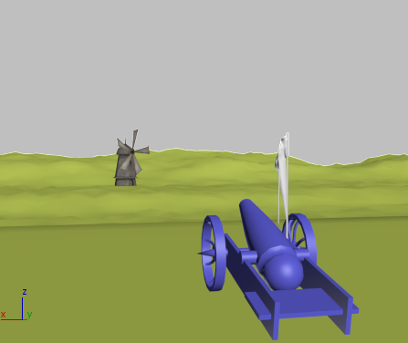

  4. Right-click the Perspective viewport to activate it, then press C.

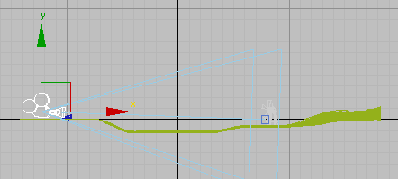

  5. On the main toolbar, click to activate (Select And Move).
    A tripod of red, blue, and green arrows appears in the Top viewport. This is the transform gizmo. As you move your cursor over the arrows, each axis label and arrow stem turn yellow. When one is yellow, you can click and drag to move the object in a single direction. If you move your cursor over the inner corners of the transform gizmo, the plane turns yellow. This lets you move in a single plane.
  6. Right-click the Left viewport, click the camera’s Y axis manipulator, and drag it slightly upward so you can see more of the horizon in the Camera001 viewport.
  7. If the cannon is not visible in the Camera001 viewport, then in the Top viewport drag the camera until the front of the cannon comes into view in the Camera001 viewport, as shown in the next illustration.
