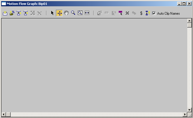

The Motion Flow Graph provides tools for adding clips to the dialog window, calculating optimized transitions, setting random script transition values, moving and deleting clips, and displaying clip dependencies. Clips display as icons and transitions appear as arrows in the Motion Flow Graph.
The Motion Flow Graph displays when you click Show Graph on the Motion Flow rollout on the Motion panel.
Motion Flow Graph

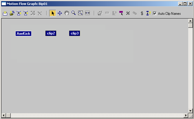

To create clips in the Motion Flow Graph:
Clip icons will appear in the Motion Flow Graph that are named clip1, clip2 , and so on.

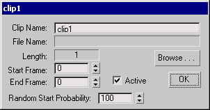

3ds Max opens a clip dialog.
The selected icon displays the clip name in the Motion Flow Graph; this clip can now be used for script creation.

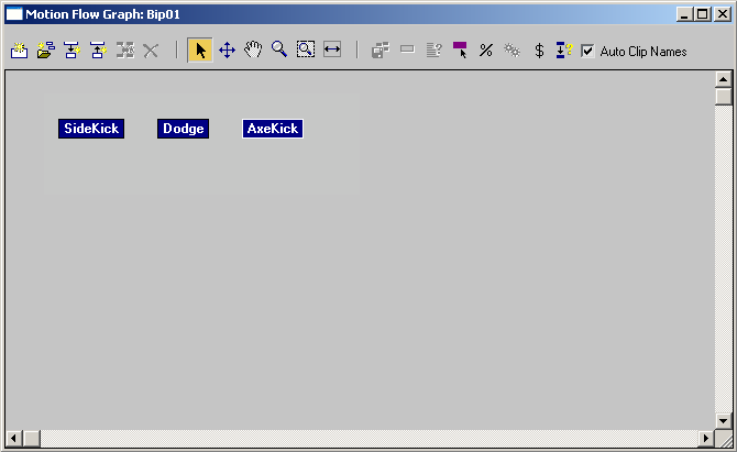

To create multiple clips in the Motion Flow Graph:
Use the file dialog to choose the location of your BIP files.
Once processed, multiple clips appear in the Motion Flow Graph window.
