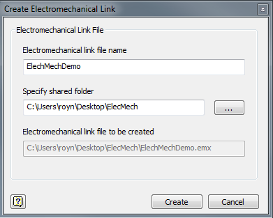

Click
on the Electromechanical Project Setup dialog box.
Enter a filename for the .emx link file.
Specify a folder that is shared between AutoCAD Electrical and Inventor.
Click Create.

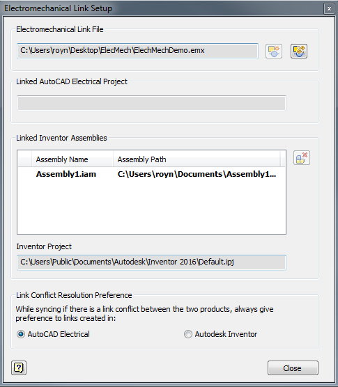

On the Electromechanical Link Setup dialog box, select your Sync Settings. The default setting is AutoCAD Electrical. The assumption is that AutoCAD Electrical users would be initiating the electromechanical workflows most of the time; hence the default is set to AutoCAD Electrical when a component link is created.
Click Close.

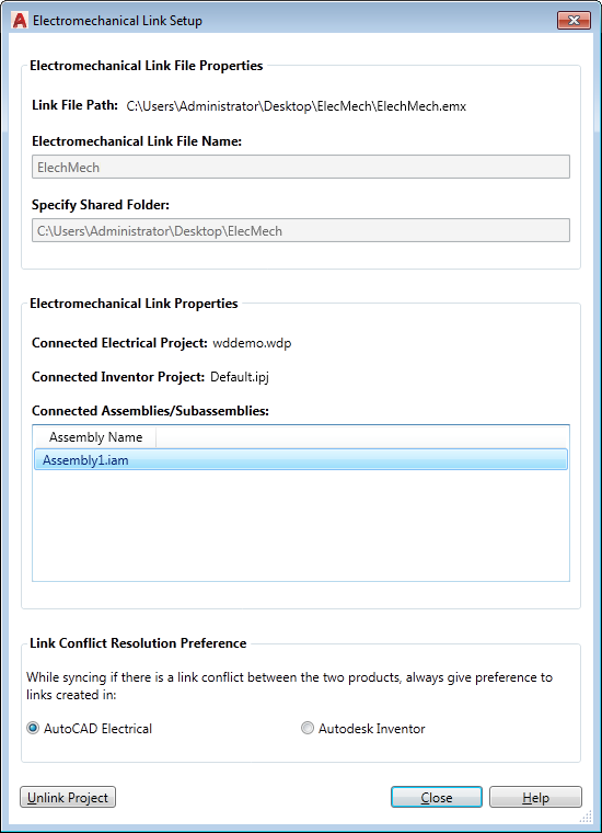

In AutoCAD Electrical:
. Find
. Find
Click Close.
