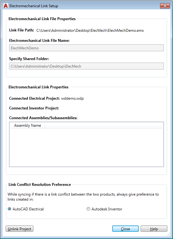

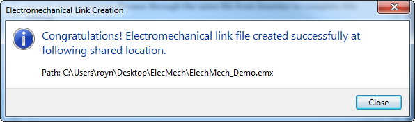

Create an electromechanical link file that connects an AutoCAD Electrical project to an Inventor project.
Linking an AutoCAD Electrical project to an Inventor project requires creating a link file and defining the two projects to link. The process involves two steps:
In AutoCAD Electrical:

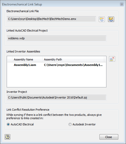

In Inventor:
on the Electromechanical Link Setup dialog box.
