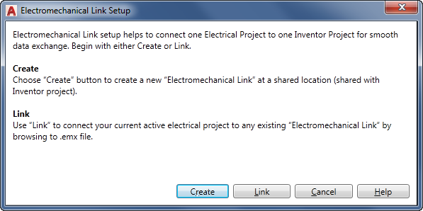

Electromechanical Link Setup Dialog Box
Create an electromechanical link file or link your active project to an existing link file to facilitate data exchange between AutoCAD Electrical and Inventor projects.
Find
 Command entry:  AEINVLINKSETUP
List of Options
Create
Opens the Create Electromechanical Link dialog box, where you can create your electromechanical file and specify the shared folder location.
Link
Opens the Select Electromechanical Project File dialog box, where you can navigate to an existing linked file and link it to your active AutoCAD Electrical project.
Cancel
Closes the dialog box.
