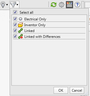

Filter components in your component tree view based on link status.
. Find
In the Project Manager, click the Location View tab.
In the Location View, click Filter by Component Status
Clear Select All, and select the values you want to show in your component tree view.
Click OK.
